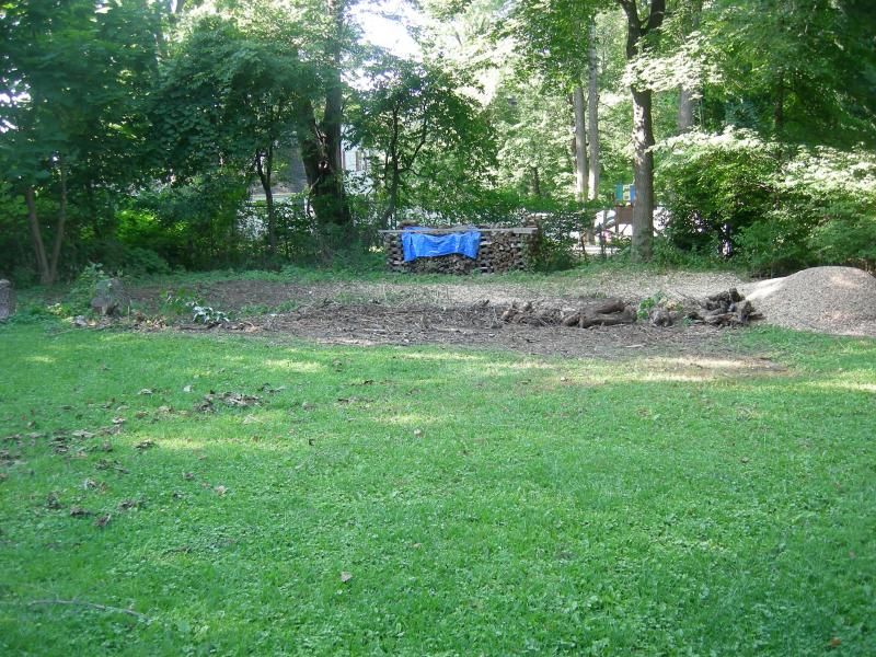

I had a corner full of brush, so to keep it affordable, chipped it and created my work area

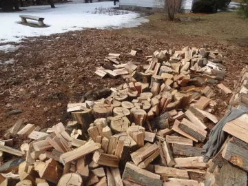

Here's the splitting I did this morning. Round set on end, four deep row. Right where I need to stack. I worked down the rows and hardly had to bend down to set pieces upright again to take another swing. Goes pretty fast like that. Process where you need to stack, as someone said earlier in the thread.

I've done this before, all the rounds keep everything from falling over.......it only sucks when you have a lot of really stringy stuff, cause then you have to go back in with the hatchet.
That's a nice days work.
So you set up rounds 4 rows deep and then go at it with the splitting axe? I would think that one swing would take out a bunch of rounds like a domino effect?

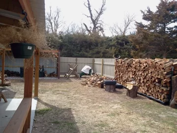

I pull out my logs to a spot along the driveway to cut , split and stack on pallets . The base is about 6" of bark , saw dust, etc. , its out of the way and lots of room . Its down around the corner , past the plywood target.[Hearth.com] The Wood Processing Area

Depends on the size of your rounds I guess. On average I was splitting 12-18" diameter rounds. A bunch of 8" rounds would fall over for sure. In my case it worked great. I've got a decent reach so four deep worked. Try three if you got shorter arms. I have an 8lb maul.
Yes sir, I had my fill of swinging, that's for sure. There were stringy ones, but if I pick up the round a chuck it, that it'll break up.
Two piles done like that 3 more to go. I Should be in some kinda shape by the time the snow melts!
