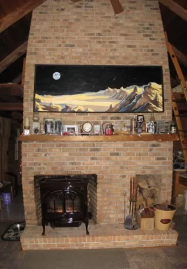

I have a Jotul F600 freestanding stove sitting in front of my massive fireplace and chimney (8'x4' running about 20' tall inside the house - over 6000 bricks). I just now took some temperature readings off the stove and chimney: Stove = 400F, fireplace 24" above the opening = 225F. Even the backside of the chimney in the kitchen is reading 86F while the living room temperature is sitting at 72F. So, I can see why you are concerned that you are losing the benefit of all that thermal mass heating you had been getting in the past. Perhaps you should have forgone the wrapped insulation on your liner if your clay tile liner was in good shape and didn't have any cracks, which requires the insulation on the flex liner. I made a deliberate decision to do my install without an insulated liner for just that reason. I installed a block off plate with some insulation laying on top of it and I stuffed insulation around my flex liner for the top 4' or so of the chimney that is above my roof line. With an airtight top cap I seem to be trapping a good amount of heat to both warm the liner for good draft and bleed off enough heat to warm the thermal mass of the chimney for slow release later. So, if your clay tiles are in good shape I suppose you could consider pulling off the insulation if it is a big enough issue for you.
