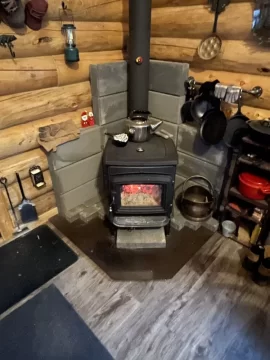

In the case of the OP, if the cabin was better insulated and air sealed (very difficult in the long term with a log cabin due to settling) with a lower heating load, it would cool down slower overnight requiring a smaller stove and less wood to maintain the temperature. That is not criticism, just an observation. Insulation and sealing cost time and money so when energy was cheap or its just a seasonal usage, the decision is usually made to use more heat. On the other extreme, Passive homes are designed to have a very low heating load due to lots of insulation and sealing and they are heated just by the sun entering the windows usually with stone or occasionally water based thermal mass used to absorb the heat and release it during the night. The tradeoff to minimal heating costs is a much higher initial cost and if the money is borrowed higher mortgage payments.
