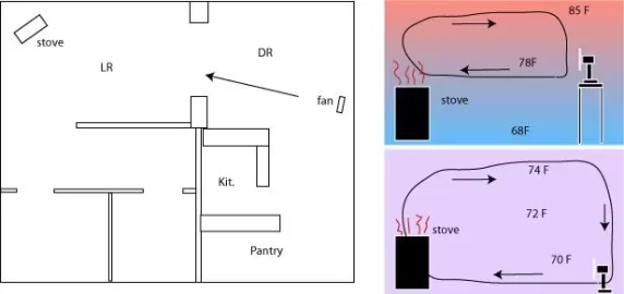

Try it. The goal is to create a circulation loop. The fan has to get it's air from somewhere. If it works, it will pull warm air from the stove, across the room, then down to the fan and help reduce the temp stratification. The cooler air gets returned to the stove low. With the fan on a stool only the upper 1/2 of the room air is circulating.

It can seem counterintuitive at first. Here is a simple diagram illustrating the idea. On the left is a rough draft of our floorplan. On the right the top image shows heat stratification occuring. The lower right shows the desired effect with a low fan running on low speed.

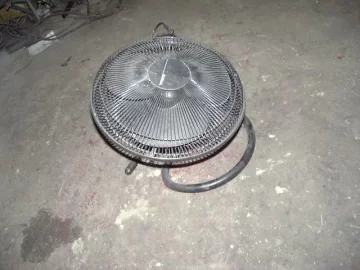

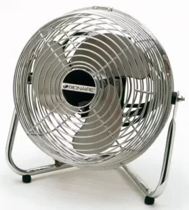

If the ceiling is too low for a ceiling fan you can also use a floor fan as shown below in the middle od the room or over by the stove area. Put the fan on the floor and point it up ans it would serve the same purpose as a ceiling fan except its on the floor. You can angle it just a hair one way or the other to get more heat to go one way more than others.
It will pull the cool air off the floor and push it up to the ceiling were the hot air is and it moves the hot air around and off the walls ..........like a ceiling fan.
I found these pic off the net to give you an idea of the style fans that do this.

hey thats an idea..Dont know if I want it in the middle of my room but its a good idea.
You can put it in different spots on the floor pointing up , dont necessarily have to be in the middle.
This waydoes a good job of moving cold air off the floor and moving the hot air around and off the walls. Ya just have to experiment with different way per the home to see what works best.
A not on these floor fans , the small ones make more wind / blowing noise then the larger ones but i guess that gos with any fan of these designs.
Best of luck and hope the ideas work for ya.
