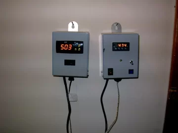

I have a digital temperature controller with a magnetic mount thermocouple(what you said you were looking for in your post) that will turn on the blower at a specific stove top temp. It will also sound an alarm if the stove gets too hot. Also, it is more accurate than the stove top thermometers.
There is not really anything off the shelf that is plug and play that I know of. You have to buy the components and assemble it yourself. If you look on Ebay for temperature controllers you should be able to find an decent one for around $30 $40.

That is exactly what I'm looking to do. I see that you have 2 controllers and it looks as though one is monitoring your internal pipe temp on your double wall, is this right? Also, does it also control your blower? Seems this would be ideal and I like the idea. Also like the idea of an alarm. I dont want to violate any posting rules (so early in my posting career) but what brand of controllers are they? I would feel better ordering direct from the mfgr. , returning items from Alaska is a real drag and kinda' pricey.

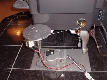

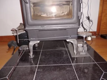

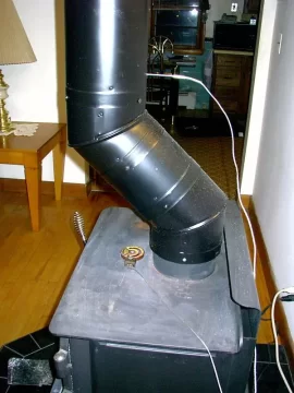

The controller on the left is connected to the magnet mount thermocouple on the stove top, the controller also will turn on the blower when the stove top reaches the set temp.
The controller on the right is connected to the thermocouple probe inside the DW pipe, this controller will also automatically close the air control when the flue temp(inside) reaches 875 °F . It is connected to a modified Honeywell HVAC damper actuator and solenoid, the solenoid locks the cable and the actuator rotates and pulls the air control closed ( about 1/3 per cycle). It is a bit Rube Goldberg but it works well and parts were cheap. It does need a little more fine tuning to get it just right.
The left controller is from http://www.coleparmer.com/Product/T...ype_K_and_J_110V_deg_F/EW-93520-01#vircatalog
It has some nice features like a built in alarm,but the price is a bit high$80.
The one on the left is from here: http://www.auberins.com/index.php?main_page=product_info&cPath=1&products_id=14
It is cheaper ($35) but if you want an alarm you need an external one. http://www.auberins.com/index.php?main_page=product_info&cPath=7&products_id=215
