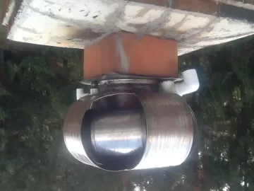

Think this chimney cap mod will work ok?

[Hearth.com] Think this chimney cap mod will work ok? I had a vacustack when I was burning wood to block wind and down drafts from the second story. I put in a 1 inch and 2 inch intake to get air to the oak in the chimney. To keep ash out, inside the vacustack I put in flashing and roxul insulation and sealed it up with the 4 in exhaust terminating inside the vacustack. I imagine I will have to clean out ash periodically inside the stack but at least it is not going back in the chimney and getting sucked in by the oak.
Anybody know just how much ash comes out of the exhaust in a season?

View attachment 119724 I had a vacustack when I was burning wood to block wind and down drafts from the second story. I put in a 1 inch and 2 inch intake to get air to the oak in the chimney. To keep ash out, inside the vacustack I put in flashing and roxul insulation and sealed it up with the 4 in exhaust terminating inside the vacustack. I imagine I will have to clean out ash periodically inside the stack but at least it is not going back in the chimney and getting sucked in by the oak.
I don't quite understand your installation but, that looks like an awfully small pvc pipe for air intake. If it is more than three or four feet long it will probably restrict air flow too much. that double el at the end doesn't help air flow too much either. That should be done with sweep el's, the bigger the radius the better.
