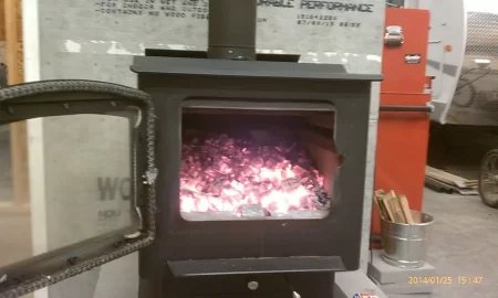

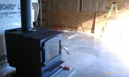

I love it. My shed is a bit bigger than most and I don't have a ceiling in yet but I do have slab and wall insulation up.
I can burn lumber scraps, cardboard from packaging, etc. It is silent and I wouldn't want it to run unattended anyways. A quick warmup is imporant and I don't think a pellet stove makes as much heat as a large 750 degree woodstove.

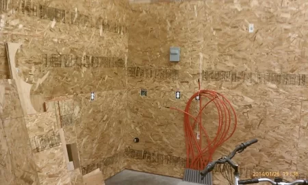

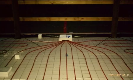

I wouldn't use a woodstove for primary shop heat. If you need to maintain a temperature, say above freezing, all winter then you need something thermostatic out there. A pellet stove will work but I chose to install 1800 LF of pex tubing in the slab and use a boiler to keep the shed above freezing, then use the woodstove to bump it up to comfortable working temps for the time I am out there only. A two stage approach.

My brother has pex tubing and radiant in floor heat for his huge garage (guessing 28x42'), 12' ceiling to accommodate the lift. Oil fired boiler (Buderus) and he raves about how nice the set up is; burns minimal oil in a building that is insulated fully and has a full second floor above the garage bays. In floor radiant heat is "the balls" for newly constructed green house operations, too.
