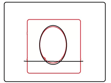

this is how I woulda cut. the horizontal black line represents the cut in the roof, the red indicates the flashing, and it's final position. don't pay attention to the outer black square, i haven't use paint in a while.

I would really think long and hard about replacing that roof. For flashing, a silicone boot or this is more what I had in mind, before the storm collar has been installed.

I also ripped off a similar metal roof and put a shingle comp roof on. Way better. The noise was bad, the looks are bad, and my old metal roof like yours had the exposed screws. Many of those screws had developed leaks and the leaks are the main reason I ripped off that metal roof. The PO had even tarred many of the screw heads trying to fix the leaky screws. Adding things like chimney flashing properly is also much easier with shingles. I support your decision.
