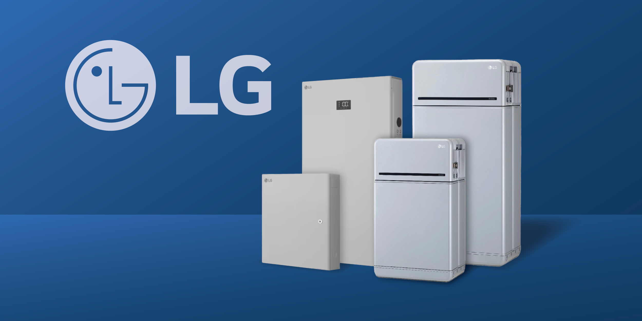

Has anyone looked into LG solar battery ? It looks price competitive with the Tesla wall.

LG Resu batteries had a big recall recently.
I heard about the LG home battery recall too. And of course, all the LG EV batteries made over the last several years were recalled too.

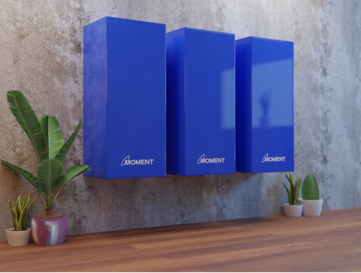

Used Leaf batteries seem popular for home battery packs. They did not have a built-in cooling system. There are even some companies selling them in backup battery packs.
And some are being used at scale.
This one is up in British Columbia
