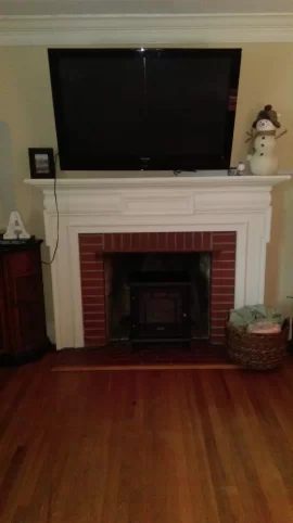

I have been thinking that the nc 13 would be smaller than I wanted once I got it. My hearth only sticks out about 15" past the face of the fireplace. I don't want anything that sticks out real far and blocks our walkways. I'm attaching a pic to give a better idea of what it looks like.

there wont be any issue w/ the tv above the fireplace would it? also, i havent been able to find the clearances needed for the nc13, will i need to extend the hearth furhter?
You will need 16" of hearth in front of the stove door. If you don't have that then you may need a hearth extender. A mantel shield will help protect the mantel and the tv. It can attach to the underside of the lintel.

im not opposed to extending the hearth. redoing the hearth w/ some other stone is something we have talked about a lot in the past. im having a hard time visualizing how much room it is actually going to take up though. also, how tall is too tall in the fireplace? i think it would be tough to get back there to make the connections w/ only an inch or two to work w/. also, where are the nc13 stoves sold? home depot shows them being out of stock and i cant find them anywhere else online. i agree that it is almost too good to pass up. it does qualify for the tax credit also doesnt it? home depot has it listed for $519. if the credit applies too, that's only $219. makes it very tempting if i can find one. i would probably have to make it work
Mock up the stove or insert of your choice out of cardboard and insert it in the fireplace to get a sense of size and proportion.
