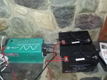

Biggest downside is when we lose power pellet stove need battery backup or go without heat. Had 8 hour run this Winter. 6 hours on 100ah battery and then couple hrs on battery for generator until I killed it and saved what was left to start generator (just in case).
This year I doubled my batterys. Two 100ah batteries (Solar Gel Cell) with AIMS 1250 Inverter/Charger. For 12 hours at least of backup power for stove. Longest outages was 8 hours in 9 years. Before that last one it was 4 hours.
I have 7k generator to charge up batteries if I need to. Along with run pump and water heater and lights etc. Never done more than test it so far.

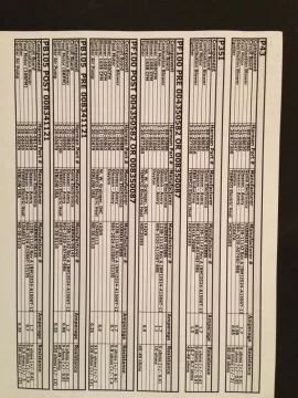

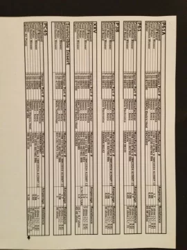

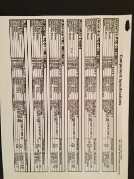

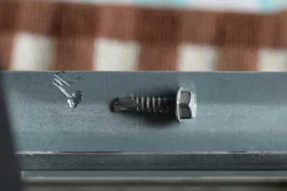

On Electrical Problems. I replaced the Distribution Fan. Sounded like motor had problems. Loud Buzzing when Cold. Seems screws were impacting housing. I have spare fan sitting now. Local Dealer I also ordered fan from under warranty. They were very slow. I gave up after 2 weeks waiting for response and just bought fan from https://www.galco.com/buy/ebm-papst-Inc./55416.29089
I highly recommend you view Harmon Video on cleaning and maintenance.
