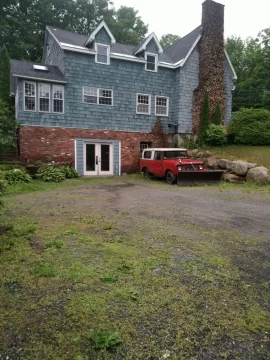

I just got a quote to have my 30'+ tall chimney with (3) 12X12 flues repaired and new heavy wall liner installed, and it seems very reasonable and fair to me. Just wondering what others think.
Here's the scope:
Take down 7 layers of brick and rebuild, replace top flue tiles as needed, seal unused flue with flashing, new corbel, install stainless cap, drill and pin bluestone hips (one fell off when I was removing vines from the chimney) spray above roof and hips with waterproofing. Total for this part including materials, labor and debris removal is $6,300.
I had him put the liner as a separate line item.
30' long 6" heavy wall liner installed - $1,800
What do you think? Could be a lot worse, right?

Staging is not going to be a walk in the park. The ground slopes in two directions, there are bushes in the way, and a couple feet to the left of the chimney there is a retaining wall and 6' dropoff.
It's the kind of site that in my younger days as a roofer, when I got there to set up staging, I'd look at it and mutter to myself "oh great" or some variation of that.

Makes me wonder what liner was used. Prices vary within the "heavy wall" liner category, don't they? Heck, just getting the vines off might be 2K. ;)
That's an old picture. I already pulled the vines off myself last year.
