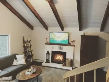

We purchased ours in January from CaptainSoot.com. It was $3900 which included the blower, faceplate, 25 foot SS liner (not insulated) and shipping from NY to WV. They have been very easy to work with and shipped me missing pieces as needed (not that it was missing anything I think our installer lost them). We had it installed through a contractor because we had to have our fireplace rebuilt due to a fire (not the good kind) but there was a lot of work involved there so I don't want to quote installation. I don't recommend having a contractor do your install based upon. Our installation. If I had to do it again I would get a professional certified chimney sweep do it properly with an insulated liner and block off plate. Just my 2 cents from a new user.
