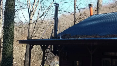

I did the same debate, with limited access to the attic I chose through the wall. Talked to one of the alleged "draft experts" at woodland direct. He was actually very sharp and helpful. So from the stove I go up 6 feet with single wall, 90 degrees then 18 inches to the wall thimble then a 3 foot tripple wall pipe to the T. I went 3 feet to get out beyond my eve and go through the porch roof instead of my actual house roof. I decided I did not want to penetrate my metal roof. Then I went up 9 feet to the cap. We just installed that last week after long time debating. Worked out great and the draft was awesome. We had no problem getting the fire started and a good draft going, and even with the stove fully throttled down the secondary burn was going well. The guy from woodland direct did a great job in giving me pointers and calculating my needs for my specific stove. And I can open the bottom of the T and clean it out easily enough from a step ladder. Everyone says going up is best, but going through the wall is just fine if you have enough pipe going up for your stove. Now just need to enclose the outside part to match the house and get my storm collar on.
Silver pipe is for the wood stove and some real heat, orange pipe is for the gas fire place for little bit of heat and ambiance.
