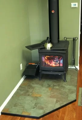

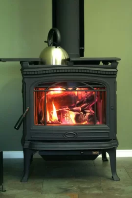

Well, today, after several weeks of slow work I had the building inspector come around to look at the installation. He voted with his signiture on the permit and we lit her up 2 minues later... After a slow heat up, we let the system soak at about 900F stack temperature for a couple of hours (only required the air cracked open a wee bit) to cure the paint and had all doors and windows open to get rid of the fumes. This stove certainly has a lot more inertia than my previous Morso 7110, but it gives off an even heat and keeps the heat down on ajacent combustibles.
Here are a couple of pictures of the install.

Looks Great!!!!!!!!
Nice! Bet you're enjoying that tonight! :)
Is that thermostat on the rear wall reading 100*?

I hope you were just kidding with 2 hrs at 900 stack temps. And hopefully that is not from a surface thermometer. It could mean you were well over the rating of the pipe for continuous duty and likely overfiring the stove. 900 surface is like 1800 in the middle of the flue. (Or did you already double the surface thermo temps?)
BeGreen, the stack thermometer can be seen right there in the second of the 2 pics about 2 ft up the single wall stove pipe. It is a true "probe type", so really measuring the flue gas temp. Given the weight of the stove, I realized it would take some time to get the beast up to temperature. Even after 20 min, I could hold my hand continuously on the cast side panels, which I didn't expect. It seems most of the radiant heat comes off the front and top, and the sides act like convection heaters.

With a probe, I have never seen over about 600 on our stove. 900 is close to overfiring, especially continuous duty. But if I can see the tiny pointer on yours, it looks like the stove is running a much cooler flue now.
It is definitely a mostly convective stove. You can snuggle right up alongside it. My cats figured that out right away.
That big unidentified object in the top left of the firebox on the first pic is a piece of lump coal 8x8x4" thick and it took about 90 min to ignite, but it has now been steadily burning for hours. Judging by the heat output, either I have too much draft, or I need to do much smaller fires and let them go completely out until some "real" cold settles in. I wonder whether part of the difference between this stove and my Morso 7110 install is due to the current single wall stovepipe. I just appear to be putting a ton of heat into this space compared to the last system. Bring on that winter.....

It peaked out at 106 F, but considering the proximity, that may not be surprising. The plan is to move the thermostat to the opposite side of the wall (inside the stairwell). It is certainly uncomfortably hot in here (said with the kitchen sliding door and 2 windows wide open...) and I will have to keep that in mind and burn only small fires for the next month or so.
I hope you are able to distribute that heat throughout the house;you'll be laughin'.I'm no stranger to having windows open in the winter either;it's hard to just keep a small fire on!!Enjoy that new stove-she's a beaut.
