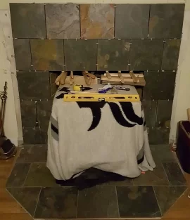

I plan to finally finish the tile job behind the wood stove tomorrow, but I have a question.
It is supposed to be cold over night saturday and sunday. If i were to tile the wall friday, will there be any issues with the thinset and a good amount of heat?
I would assume it would be okay. Maybe even help the thinset firm up easier with the heat. If its not a good idea ill just hold off till the next warm couple of days.

Just finished tiling the wall up to where the mantel will be. Tomorrow i will grout and then wait till Thursday to burn again. This is probanly the last week ill be able to not burn or run the furnace.
Mantel is an old building beam. 90+ year old Fur beam. Gonna cut it down to 6 feet and it will extend 6" past each side of the tile. Itll be 8" deep and 3" thick. Not sure if i will finish it or not. I think it will look nice with the front edge rough cut, but the rest nice and smoothed out. Any suggestions?

Nice work on the subway tile. I like tiling but, man, it's such a tedious process. Every step you have to wait for 24-48 hours before moving on
