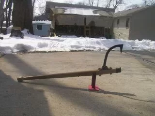

I used one with the rigid foot under it. Nice for bucking small stuff but it has to be totally round. Any branches or forks, it didn't work. It has to roll the log as it picks up, and if any branches prevent that, it didn't work.
So I added a pivoting foot to my cant hook and it works great. Light angle on each side, downto a flat plate. pivots on a pin through the handle. allows the leg to stay in one place while the log rolls a bit.
Not intended to be a holder for cutting, as it doesn't go 'over center' and hold it up. Use is to lift a log and allow putting some blocking under it.
