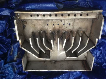

I took the top off and there is about nine slats inside . One straight in the middle two angled slightly towards the middle one and the rest keep angling in . Not really rocket science to copy .
You can make an exact copy quite easy ...

Ok for those that are reading / following
I'm not using stainless steel that is available at your hardware store .
I'm using 1/4 inch stainless that is in incinerators that reach 29,000 +degrees and run 24/7 so warping will not be an issue .
And the more research I do actually suggests a more Eco friendly stove but way too expensive for a regular home consumer to purchase ...

[Hearth.com] Timberline / resolute acclaim refractory question ? Almost completed .
Think it will work better than the previous .....

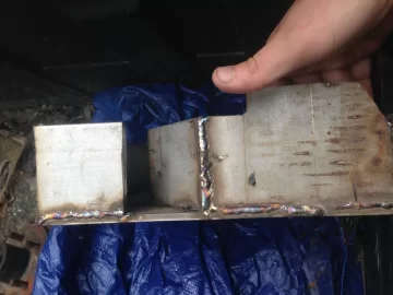

  • [Hearth.com] Timberline / resolute acclaim refractory question ?
I don't see how if you do get proper combustion in that chamber that you will not end up warping that really quickly but hey its your house and your stove. I am curios to see how it works
