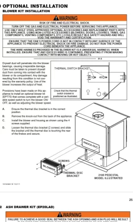

Hey guys! Just had my first small fire this am to check the operation of my new blower I installed this summer and to my surprise it didn't work.... Stove top temps got to 450 and nothing from the blower... It's plugged in and the switchis indeed turned on. Any ideas? Am I missing something here? Thanks !
Could be a bad thermodisc.
also I see that the thermodisc bracket is adjustable. Make sure it is touching the back of the firebox.​
Here is a copy of this if you need it.
[Hearth.com] Timberwolf 2200 blower

K got it adjusted it forward some more added some more wood and right around 450 it came on! Does that sound about right?
It is really hard to say. Stove top temp and where that is mounted on the fire box are going to be two different temps. It sounds about the right temp to me though.
