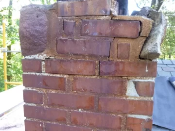

I removed the crown today; You were right, it came off pretty easy using the cracks that were already in it. ;lol As you can see, they tried to get cute with the decorative granite pieces on the corners. They are weak points and develop cracks in their mortar. I'm thinking it would be best to get rid of the four granite pieces and to have the top four courses re-laid by a mason. As you can see, there are some bad bricks further down than four courses, but maybe @bholler or @webby3650 can give me advice on possibly just taking out the loose chunks of brick and patching the gap with concrete? You can see that the other sides are in better shape, just need some mortar joint repair. I have more granite further down, but I'll just have to re-do the joints as best I can. My main focus right now is getting the top re-laid and then put the crown on myself.

These sides aren't as bad...

By the time this top is re-laid, it doesn't look like there will be big gaps where there will be a lot of wet concrete to support. I don't know if, for the bond break, I will get a sheet of stainless, or as bholler sometimes does, "plastic." Not sure if he's talking about 6 mil plastic sheet, or something more substantial that will hold the weight of wet concrete?
Well that looks like a roofline up rebuild to me but you could pull out the bad brick and replace them. Just filling the missing sections with mortar does not work well.
What's your guess at to what it might cost, just the four courses, and then for the 'roofline up?' But I'm certainly inclined to go the whole nine yard, like you say, and be done with it for a while (I could get rid of some of the stupid granite, too.) I guess I'd want to leave the flashing undisturbed. Besides being a pain to re-do it, I'm kinda proud of it...it's a cut above my usual level of hack work. ;lol
Anyway, the chimney brick structure measures about 22" x 40", to give you some idea of how much work it might be. I guess it's best to go with new brick (hard brick, I think you've said in the past, but I guess the mason will know.) I'm not really too worried if the color doesn't quite match but I want something that's gonna hold up. Also, is it best to go ahead and replace the clay liner tiles while you're at it?
your brick are already modern brick not old soft ones. For a roof line up rebuild and poured crown you would be looking at around $1500 here.

Not worth the time to clean them honestly. We only reuse old brick if we cant match them close with new brick. But in your situation where it will all be above the roof with no visible joing to the old chimney there is no reason to reuse them.
If you do the crown I would say it would go down to $1000 to $1200
