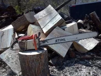

After a PITA getting the ignition parts gathered up for this beast, I finally got it all back together and fired it up tonight. Lots of power!! Still got some fine tuning to do, the saw seems to 'hunt' at full throttle, may put another carburetor on it to see if it makes a difference. The carburetor on the saw now is from the 510 cutoff saw, not sure but it may be a little different than the 051 chainsaw carb. Here's some pics, I'll do a video when I get it tuned right and something to cut with it.

here's a pic with the 36" bar. Gotta get a new full chizz chain for it tomorrow.

well I got a chain made up for the beast today at the local saw shop (he only had the Oregon LPX chain, no Stihl Oilomatic, had to settle for second best ;)), and I figured out the 'hunting' problem I had at full throttle. Just as I suspected, the carburetor I used on my build was out of a cutoff saw, so it was GOVERNED. Which would not allow the RPM's that I needed for the saw. I did a modification to the governor and it tuned up nicely! Also wrapped the full-wrap handlebar with some cushioning tape. I MAY take an hour or two tomorrow morning and make the custom muffler I so desperately want for the saw, that will free up some more power too. I will be heading over to my cousin's OWB woodpile tomorrow (he's got some big ol' logs in that pile) to seat the new rings and break that saw in right. I'll do a video and post it on here tomorrow.

Well as promised here is the break-in video. Not the best quality (I'm no producer/movie star), but as you can see and hear, the saw runs pretty good.
Ended up noodling all those logs. Would have filmed it but too hard to keep everything right in front of the camera (not to mention keeping my phone propped up on a log to film it)...
