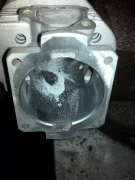

    Finally got the old 051 torn down last evening. Sitting in a kerosene bath right now, honing the cylinder today and putting the bottom end back together this evening. The bottom end is in great condition, top end is too. One ring was frozen in the piston but no scuffing or scoring. Installing new rings so that don't matter anyway....

    Almost ready to put the ol' girl back together..still waiting on a new oil pump drive gear and f!ull wrap handlebar mounts, and a couple other odds and ends. Still have to port the cylinder and open up the exhaust too. All parts are cleans and awaiting reassembly! Resampled952012-03-169516-35-3995465.jpg

    jist finished with the cylinder, intake, and exhaust porting. Also cleaned the casting webs out of the piston ports. One step closer.....here's some pics.
