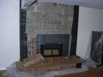

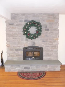

Now, while I am waiting for them to get back to me, anyone see any issues with my install. It was done by the company who I bought my stove from, they are still around. I am not sure if they company will care about the stone work as it sits on top of the metal surround/back plate that sealed up the opening. Although it is probably irrelevant, the instalation was done in 2006 and has been working great at about 3-4 cords a year since them.
