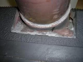

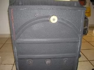

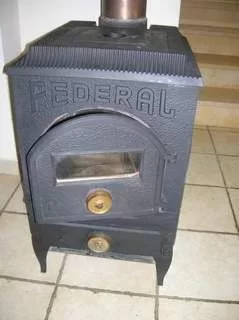

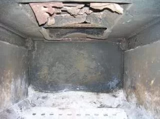

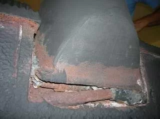

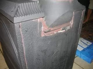

well, as i noticed in my recent massage, i checked a twenty years old ‘Dutch West-Federal’ wood stove. in the pictures i saw on the web, it looked fine. today i went to see it and...well…
the inside of the stove is baddly rusted and it looked like it was over heated. there are few tiny holes on the body of the stove, especially on the back and near the conection to the chimney. in fact, the owner of the stove told me that he seals the cracks from the outside every year with some kind of very strong polymer but it looks cracked and broken. there are two major vertical cracks on the sides of the back. the guy told me that the only bad thing about it is that the efficiency of the stove decreased but still it works great. im not sure about how long will the stove function in the future. i attached few pictures of the inside, the back cracks and the area of the conection to the chimney.
ill appreciate your advice.

I would not consider purchasing that stove if it were myself. Cracks and holes in a stove that was probably casted in Taiwan are probably only going to get worse.
I vote "not to buy". I would rather buy a new inexpensive stove before I buy a twenty year old pre EPA wood stove with a bunch of holes.
Besides, you will be money ahead on wood savings from the new stove.
Pass on that one, gigi. Rick
Good that you asked Gigi. Word is that the early Dutchwest Federals were not of the best quality to start with and this one has had it. There is a better stove for you out there. Keep trying.
Hmmmmm ....holes....giant cracks.......completely decimated baffle/flue area........Holy Moses !
WoodButcher
I vote send it to scrapp yard fast....... no no faster...ZZZim
let her go!
NOT!
Good decision. Keep shopping. Rick
