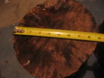

I will be ordering my new stove this week (caliente chilli sunset red, I believe "whorehouse" red was already taken), Pacific Energy Summit classic. I have an abundance of ponderosa pine logs and rounds that have been lying around for nearly three years and are EXTREMELY dry. Since pine burns so fast anyway, should I possibly consider not splitting up the rounds and just burn the logs round?.
My thinking is that since these logs are so dry (kiln dry moisture or less), if I split them up, they will burn up in 10 minutes. Maybe I could get a good fire going and then add a full round to it. What do you think?
I think that buring alot of pine (split or round) is a bad idea unless you're going to have the chinmey cleaned 3x a year.
I would split them if they're bigger than 5-6" diameter. You need the edges to catch the flames and start the logs burning efficiently...you also cannot laod up the firebox as efficiently with rounds as you can with splits.
It's always a good idea to have a mixture of both split and rounds, but I suspect your original premise is right. In any event, I wouldn't split too much of it before you see how everything works.
I would give them a shot before you split all of them. Pine is not bad wood, it burns plenty hot, it just burns very quickly. I would try a round or two before you pack the firebox with it, especially if it is that dry.
As for pine causing a dirty chimney, that's just not the case. Just as with any wood, if you season and burn it properly, you'll have no more problems with pine than you will with oak, etc...
It is best to have a mix as Eric said. Although, personally I do like to leave it on the bigger side. Once you get into steady 24/7 burning you will be glad you left those 6-8 rounds whole. (The largest a summit can take is 9"dia) The bigger rounds will extend your burn and flatten the heat curve, especially with pine.
When your going to be away from home for 14hrs and it's -20C you break out the big stuff. :-)
