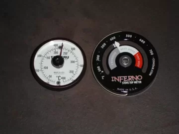

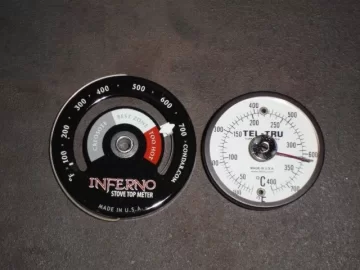

I did a little comparison between an expensive piece and one of the cheaper ones. Not too far off (differential did not follow the thermometer when swapped side-to-side). This is all I know...
