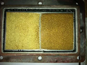

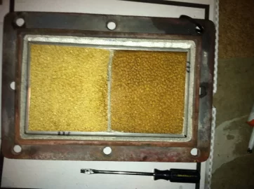

The new cat did not fit tightly and may have created a leak. There was a 1/2" gap or so on one side. I ordered the interim and cat wrap gaskets but it also came with another flat rope type gasket. I used that to seal the gap and coated it with 2000f furnace cement. Would that have sealed it or maybe it failed at the thicker gasket material?

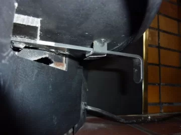

Seems like I remember reading about tightening up the sliders, bending the rods, or something like that. Like, they're closed like they should be, but aren't tight against the air inlet.

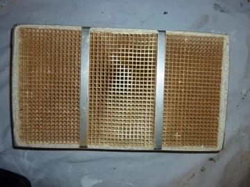

That doesn't look like the cat in mine. Where did you get it? But a leak around the interam gasket wouldn't make the stove burn hotter; That will be a function of how much air is coming into the fire box.

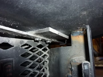

Bmore, if the stove is used, I'd replace the door and ash pan gasket for sure. Having 25' of stack, any air leaks will be magnified in your setup. I have 21'. Use OEM gaskets, as they have the proper densities to do the job. Make sure you have the ash pan gasket up high, across the top. The one I just replaced, I let it get a little low in the middle, so rather than tear it off and re-do it, I just slipped a piece of sheet metal in the bottom of the ash pan housing to bring the entire pan and gasket up a little higher for better contact, until I get around to replacing it. It is sealing pretty well. You can tell if the ash pan gasket is leaking by the way the load burns. If you see a lot of hot coals around the ash dump lid, you know air is coming in there. I also replaced the door gasket and I can tell that it helped because the glass is staying clean except for the bottom corners, even though I cruise with the air pretty low (left slider closed, right slider about 1/4" open.) I used high-temp (700 intermittent) copper silicone from the auto parts store. I also dabbed a little on the ends of the gaskets to keep them from unraveling over time. When I got the stove, there was a huge gap in the ash pan gasket where the ends met.
If you look under the 'hearth' (ash lip,) you can see the workings of the air sliders rods and plates. One of the first things I saw, as jeff_t mentioned, was that the plates aren't tight to the air inlets. You could bend the rods, but I chose to take a more easily reversible approach...I just cut a trim coil strip and wrapped it around the bottom of the saddle for the slider rod. I did this on the right side only, the left side didn't have quite as much gap. I may try to tweak all the air plates more closed to go for a longer burn, but I think the risk is a back-puff if you try to run the air too low, depending how strong the stove is drafting due to outside temps, etc. The way I have it now, you can't cut the air enough to crash the cat or get a back-puff. I kinda want to keep it foolproof in case my wife or SIL loads the stove. But I can run without flame if I want. This also depends on how much of the load you have gassing when you cut the air and cruise....you may get intermittent flash-over flame for a while. Yeah, if the cat probe is holding 800+ even when you cut the air, the cat is burning. If it gets up to 1000 or so, you will begin to see the cat glow if you look in around the bypass rod hole.

I have purchased a new door seal and will check the sliders when we get a break in the weather. I purchased the cat from Clear Skies Unlimited, catcombustor.mybisi.com . It was under $200 at the time and is now $250. Much cheaper than the ceramic OEM replacement. I previously posted a thread asking if anyone had tried this new type, but didn't get much feedback. I will let everyone know how it does, although I have never used the pricey ceramic ones. To compare to.. The new cat is only 1" thick and looks like a sponge. They claim it was designed for open fireplaces and is not impacted by direct flame contact. Also said it can be ignited at lower temps around 400f. I found this to be true. I close the bypass even shy of 400 and it quickly climbs to 800-1000. I Like the very fast start up time. Just would like the longer burns you speak of. Thanks!
I musta missed that post. Those fly-by-nighters ripped me off; I ordered 2 cats for the Dutchwest a couple years ago, but only got one. They never answer their phone, and multiple emails to a good address went unanswered. Luckily, I only lost $40. Next time I visit my Sis in NM, I'm gonna drive by their office and run over their mailbox. ;) The ceramic cat for the 91 is around $290, so I would go for that one next time if the Brillo pad craps out and is $250 to replace.
