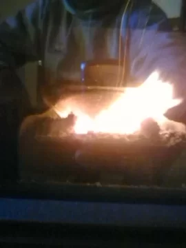

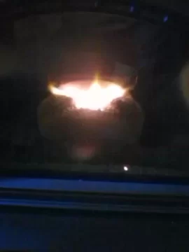

this is after about 20 hours of burn, feed rate 6 (max), and temp set at 71*. Is this the way the ash should pile up? It seems like a light fluffy ash when I cleaned it out yesterday. I figure these are cheapo pellets(free w/ stove) but didn't know if even that would pile ash that high. Fire seems awful low in pot, right at the end of the auger. Wifee just picked up a bag of Penningtons ($6.50) at WallyWorld to try. :roll:

Seems about right but it's hard to see... a better pic would be with the flame out and the door open.
I would think you should have a lot larger flame... have you been scraping the burn pot everyday? Pretty much necessary on the Harman's I've been told.

yup, scraped it out good yesterday before I restoked it, 1/16" of black crust at the bottom of the firebox and a LOT of ash. thought the fire would stay more up in the middle of the box until it goes to low flame. Guess I'll try whatever pellets I can find (reasonable $$) and keep futzing. Are Uncle Jeds pretty good?
