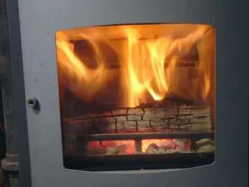

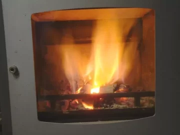

Here's how I do it on the X33:
: Rake the coals into a pile in the center of the stove
: move the Burn Type lever from overfire to underfire air
: close the secondary air control
: adjust air control for coals burn rate (it doesn't take much)
First pic shows the resulting flame. It's much whiter that the camera captured.
Five minutes later, coals have burned down and stove body is very hot. Rake coals out, move Burn Type back to overfire, open secondary air, reload, and the wood takes off instantly with full secondary burn. See second pic.

Question on the 'secondaries'. On the inside top of my stop I have 20-30 holes the size of pencil erasers. Certain times they will have flame coming out of them. Is that the secondaries? There are three types of secondaries that I have seen described. The one I most often see with my own woodstove is what I have dubbed the Bowels of Hell or Bowels of Hades . . . there may be a few,small, lazy flames on the wood . . . but in the top of the firebox it will seem as though a portal to hell has opened up . . . it will seem like a pent up and very pissed off dragon is attempting to huff and puff his way out of your woodstove . . . you may see this the first time and be convinced that you will be responsible for burning down your home . . . do not fear this. The second type I have not seen personally, but I have seen the pics here -- little blue jets stream out of the baffle's holes that you describe and the effect is almost like a propane BBQ grill. The final type I see occasionally . . . especially when my temps aren't as high as they should be -- I have small, lazy flames on the wood and then these Northern Lights kind of "explode" into view . . . I mean there is no concussive explosion . . . rather the smoke just kind of ignites . . . almost like a fireworks show . . . typically these last for a bit and then the Portal to Hell opens up in my woodstove. Also, should I see flame coming down the front of the glass (I don't)? No . . . at least I don't . . . unless the aforementioned Portal to Hell has opened up in my woodstove at which point you will be convinced that the glass is about to melt away . . . once you see this . . .you'll know it
Definitely the kind you haven't seen. Propane grill like flames is the perfect description. I have to pay more attention to my flames. Sometimes there is A LOT of flames inside and I just don't know where they come from.
I'd have thought after 27 days I'd have this figured out but I still have a lot to learn! I read my owner's manual again and between that and talking to you guys I definitely am not being as efficient as I can be.
The wood stove is in my basement (not where I wanted it) and am thrilled it has been keeping the geothermal off on the 1st floor 80-90% of the time. I didn't know what to expect but at this point I think it is saving me a couple of hundred dollars a month! Need to see that electric bill now.
Sounds good . . . I never see the propane grill effect for whatever reason . . . as for learning . . . trust me . . . I'm still learning . . . and still making mistakes and slowly learning from those mistakes . . . when you head into Year 2 you will be amazed at how much you learned during the course of Year 1.
