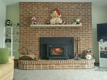

Yesterday I bought and scheduled to have the Summit insert installed upstairs. We'll do something in the basement fireplace next summer once we get settled in the the home. Thought I'd try to post a pic for the first time, below will be the Summits new home.

The Summit was a good choice. I see a wall register in that picture...is that hot water heat? Reason I ask is because if using wood 24/7 are you still going to cycle the boiler once in a while? I had this issue at my last house and ended up installing anti freeze in the hot water heat system. Unless maybe that register is electric.
Yes it is, never even thought about it and thanks for pointing it out. The hot water heater is part of the system so I guess we should be ok then? I know very little right now about this type of heat. It has thermostat in the living area and in the very back master bedroom, so it may kick in at times back there depending on how high its set. Likely not 24/7 only cuz we head up to our cabin a couple times a month in the winter.
Okay, just wanted to make you aware. Hot water heat systems often have pipes running everywhere in a house, including outside walls. Not a problem in mild winters but when it gets super cold like -30 I would just make sure you cycle the boiler a few times, thats all. I guess that is of course if a boiler is in the home. You mentioned a domestic water heater?
Or at least I think its part of the boiler, again I'm not yet educated on this type of heating.
