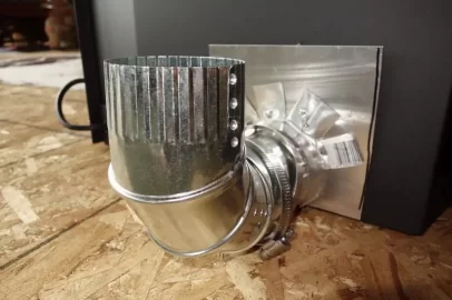

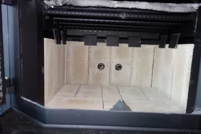

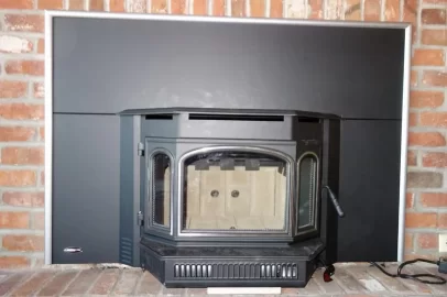

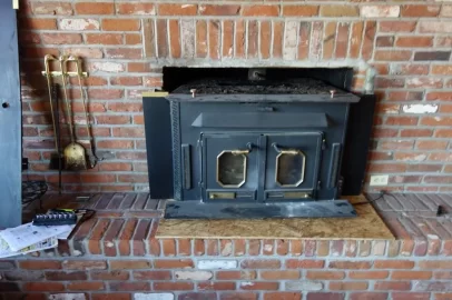

I figured out a solution for the Oak, and fabbed my own bracket for the quadra Fire 4100i to tie to a 90° air intake down the chimney.

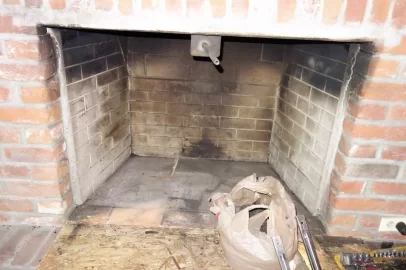

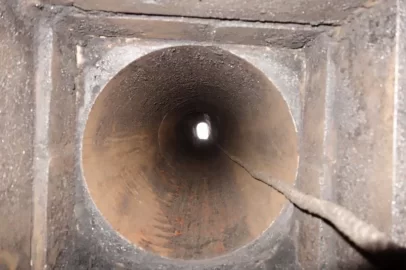

Had a bit of a snag when the old fireplace came out, the sweep says, you have 13" x 13" flue at the top, that throttles down to a 10" pipe. That made stuffing a 6" flex exhaust, and a 3" flex intake a bit of a challenge but we got it done.
Now I can't stand the thought of dirtying it up seeing's how it's 54° outside.
but think of how much purdier it will be with a FIRE in there!!

Very good looking install It will look much better with a fire in it though. ;)
Pete
Nice looking install.
nice install think it would look better with a fire in it :)
Ooh a QF 4100i...not too many seem to be around here.
I'm glad you didn't get the cast iron trimmed surround. So heavy to remove single handed.
How tall is the chimney?

Chimney is about 26 feet
