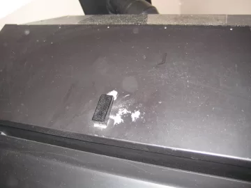

could someone here tell me what brand or type of paint I need for
my HarmanP61?
A Member of the family with longer fingers nails than me should not be opening the hopper I think..lol

Hopper is not a hot or even warm surface. A good satin black paint will work. Just do the entire lid to make it look as new. I use Meeco's 1200 Stove paint on the hot surfaces. Prep the surfaces well by scuffing and cleaning with acetone or alcohol and that's half the battle.

I'd like to take the lid off.
looks like about 8 tiny allen
like to take the lid off to paint it.
looks like it's hinged with 8 tiny allen screws..
