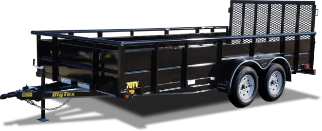

Am I going to regret pulling this relatively wide and heavy trailer with a Durango? The Durango is actually rated to pull more than my current Ram 1500, but does require a weight distribution hitch (WDH) for a trailer this heavy, whereas the WDH is only "recommended" on the new Ram 1500.
My biggest perceived issue is actually not towing capability, but visibility. The body on the Ram 1500 is 9" wider, and it has much more substantial mirrors, and I'm used to towing my trailers with that rig. I know I can put silly big towing mirrors on the Durango, but doubt I'd actually be committed enough to do it, every time I hook up a trailer.
Have any of you towed a heavy or large trailer with a smaller SUV? What are your thoughts on this?

I actually took the trailer pictured above to the Dodge dealer this afternoon, and towed it around a bit (empty, no trailer brake on the vehicle) with an R/T Durango. The mirrors need extenders, but it could work as a tow vehicle. Like you, I forget it's even there when towing the empty trailer with my 1500, and you feel it a bit more behind the Durango. However, with the same engine and just a tad bit more curb weight, the Durango is more than capable. I load that trailer right up to the 7000 lb. limit with fire wood, but really only tow it short distances. I might do much longer distances with my boat trailer, but that's under 2000 lb.

Yeah, if my trailer were smaller and lighter, the Durango would get better consideration. But I load that thing right up to the 7000 lb. GTWR almost every time I haul wood with it. The R/T Durango (5.7L) is rated to 7200 lb. gross trailer, which would get me there, but it's right at its limit.
Be very careful about depending on anything resembling a "tow rating" with these little half tons and smaller. All too often you can't get there without exceeding the GVWR of the tow vehicle. Get a hold of the curb weight of the actual vehicle, the GVWR, and the GCWR. Axle weight ratings sometimes come into play as well as tire ratings but on the half tons you hit the GVWR really early.
This is how I went from my chevy 1500 pickup with 400#s of legal cargo capacity to my F350 with 2500# of legal cargo capacity. Tongue weight of a 7000# trailer is 1400# which as you see would not work for the 1500.
