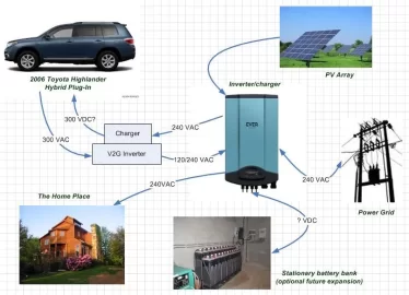

So, we're considering buying a used Highlander hybrid 4WD and then adding additional batteries and a charger to increase EV-only range. I've researched and kits are available and seem to work well. We may also use the added batteries for additional power backup for the house.
One drawback to this is that federal tax incentives seem no longer available for EV conversions, only EV purchase. I hope to get some input here on the overall sanity of this plan and thoughts on other alternatives or ways to do this and something else that I may not be considering.
