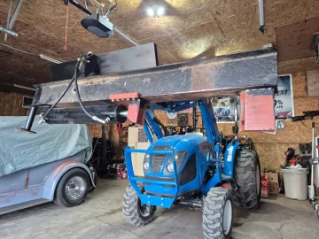

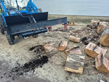

Built a splitter for the tractor. Its purpose is to break up larger rounds vs building a log lift for the splitter. Dont plan to use to split to final size, just to managable chunks. Tried it out on some oak rounds. Works good! [Hearth.com] Tractor splitter

Good job Gearhead. Used upside down, great idea no lifting large rounds.
By the way, what's that I see hiding under the tarp?

1930 Model A.
