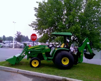

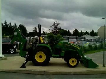

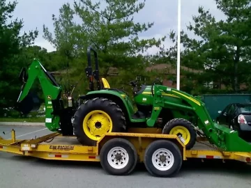

1.) 4720/400CX/448 with Golf tires
2.) 4320/400X/448 with R4's
3.) 3320/300CX/447 with R3's (photo is very dark but you can see the profile difference compared to Golf's)
Sorry, no R1 pics, they aren't very popular down here. ;hm

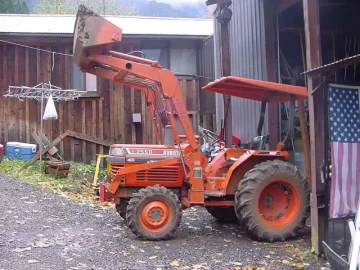

Do yourself a favor and listen to what others in your area have found, will save you some headaches. I try to take advice when offered. Stay far away from grey market tractors. I have a Kubota with ag tires and works well, Tim
  • [Hearth.com] Tractor tire advice needed
