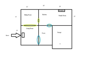

Okay so I did a rough floor plan drawing. All the ceilings on the first floor are 9'. The Foyer is about 18'. My master bedroom which is above the garage has vaulted ceilings about 12'. The rest of the rooms upstairs are 8'.
The green circles represent a doorway with a header. The blue circles have no header so the heat can flow through the door way easily. We are always in the family room and kitchen, but a propane fireplace was already in there so I didn't want to take that out to get the wood stove in there, but I am very tempted to swap the fireplace and woodstove.
You guys may be right that the wood may need more seasoning. I'll have to pick up a moisture meter and see what the percentage is. Not sure what kind of maple, but it is a hardwood and its local. I live in Lancaster Pa.
The front living room is hot from the radiant heat of the stove. The dining room is usually cool since all the heat flows straight up stairs through the doorway without a header. The family room and kitchen stay around 63 and struggles to hit 65 unless I am running my fireplace which I am trying my best not to do. The upstairs foyer gets around mid to high 70's and all the bedrooms except my master get to high 60's. My master is always chilly in the low 60's.
So my plan was to get a wood stove that pumps out more heat per amount of wood. Try it in the current location. If it still didn't heat any better, I want to move the hearth to the wall opposite of the kitchen and run the chimney up through the master bedroom in hopes to rob some heat off it and then continue it up through the roof. This way here the main room is heated and hopefully there will be enough heat to go up through the foyer and heat the upstairs bedrooms and have the chimney help heat my master.

I don't think it has ever reached that high. Mine usually cruises around 350-450 or so. I will load her up today and see what she can do.

Unless you have a good convection loop going on, you may not heat the house 2700sf as you like with any stove.
Gotta have truly dry wood & good circulation of the heat produced in most homes that size to heat the space desired.

Looking at your floorplan, I agree with you, the Family room would have been a better choice. 2700 sq ft in a house with so many rooms might be a challenge and I kinda like begreens idea of a second stove, that is if you are not buying your firewood. If you are, you may just want to kick the propane fireplace on every evening and get the place comfortable, then shut it off at bedtime. Firewood like propane can get expensive which is why I c.s.s. my own off my own 100ac.
