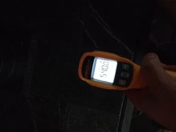

Well, I am happy to say I finally hit the number I was looking for :)
I tried to make sure I did everything right this time. Starting with a bed of coals.
-Split my current oak splits into smaller sizes, about 3".
-I checked the moisture of each and they all are between 14%-20%.
-Loaded about 12 splits in the stove.
-Let the splits burn with damper and intake wide open for about 25 mins so everything was charred
-Closed the damper fully closed and left the intake wide open
-Kept it like this until stove top was about 400
-Closed the intake to half for 5 mins
-Closed intake completely
Now I'll see how what burn times I get....

Great progress. I bet you can make the stove hotter.
