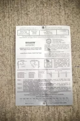

i see that you have the manual for the trailblazer 1700, i need the installation clarence for it from the manual or the plate fr the insurance co. can you help
Yes I have the stove manual. Clarence is listed on the plate on the back of stove. I will get it for you in the morning Sept. 08 2011. Stove is in my shed. Just setting there. Will that be ok for you?
Trail Blazer Diagram to get clearances from plate. Let me know which numbers on diagram you need so I can get you the clearance notes
i needthe clearances for fig. 1, back wall and side wall, can you make a copy of te plate or the manual, i need it for the insurance company, this way it will show the name of the stove and manufacturer. i really appreciate this, i will probably need the floor protector also, they are real painsin the ass, i have been argueing with them for weeks because they can't read my plate, bill
Clearances are only on the silver tin plate only, not in the manual You get a glare on the silver plate when you take a picture of it. Have any ideas how to do a copy?
The clearances are minimum in inches.
Back of stove is 20 Side of stove is 30 inches both sides
Hearth is 8 inches from stove sides back 8 inches front 18 inches
The plate states that the hearth pad be 3/8 min. thickness non combustible material or equivalent. or as code in jurisdiction See Diagram
Testing Lab Braun Intertec North West inc.
Port Land, Oregon USA
i am trying to take a picture with my camera, will let you know how i make out, try taking picture covering flash with black tape, will talk to you tomorrow, thanks bill
I had my neighbor come over to look at the plate she does photography for a company. She said she thinks she can do it. She is going to do it 9-9-2011 about noon. She has the digital soft ware to get rid of the glare etc. Wish her luck. I will send it to you if it works out or post it.
I will Let you know the out come Hang in there Keep us posted.
She took the picture on the information plate for the trail blazer stove you can read all of the plate on the camera. She said she will put them in computer tomorrow and do some adjustments so they are better to read. Will be posting them 9-10-2011. Hopefuly.
I have the file with about 6 pictures of the plate from light to dark. I will post the light one on Hearth net. But the pictures have to enlarged in paint or fax viewer or some program to be able to read all of it. If you will PM your e-mail address I can send the whole file to you or just the best pictures on the Trail Blazer plate I just got them about 5 minutes ago. It took awhile to get them back to be able to read. Let me know how they turn out for you and the insurance company. Thank for the patience on waiting. Allen
