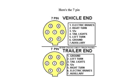

I like this one too, shows the std wire colors too. Less readin' to do. ;lol

What do you have for a connection to the truck Dave? 7 way (blade or RV style is the most common/versatile) is the way to go. I have a combo 4-flat and 7 way RV connector on the truck. Got tired of carrying/losing adapters. Now I only carry a 7way RV -> 6-way round adapter in each truck. And that rarely gets used.
