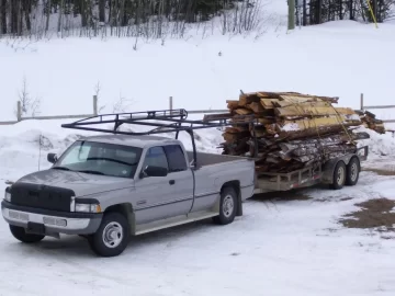

Couldnt build this one for $1795.oo Has electric brakes to boot. Sides dont work for me as I place 3 quads side ways on it and a lot of gear. A half dozen ratchet straps will do the job. Make sure it has electric brakes or surge brakes as a minimum. 8000lbs is its rating which I use for hauling 800 gals of water every two weeks. It was purchased in spring of 2004 when steel prices were lower.

Nor go to buy it if it was for sale ;-P Boy, you sure are "up there". Gotta ask....was that picture taken yesterday??? ;-)
That is exactly the kind of trailer that is relatively cheap around here. Lot's of contractors have moved south and need to unload em'. That's what you need though....and a good tow rig.

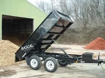

Get yourself a dump trailer. There is a good reason why you can't seem to find them used. Nobody lets one go once they have one ... and even if they were so inclined they sell to family or friends so they can borrow it back. ;-)
I have a Bri-Mar Rascal 6'X10' dual axle. It has brakes on both axles and is rated for 7000 lbs which means it can carry roughly 5300 (by the book). I have hauled 4 tons of crushed stone in it several time and it handles it like a dream.

ccwhite how much did you spend on that thing? new or used? i found a used one on craigslist 2 weeks ago for $2000. it was about 5 years old and supposedly in great shape. i really wish i had the money to buy it, because i thought it was a great deal. the only thing i found close was a tandem 7000# non dump new for $1995.00 but that dump sure seems like it would be helpful.
Beatles,
I bought new. I would have bought a used one but no luck finding one around here. Even with mine if I decide to sell I already have a couple of friends in line to buy it.
You'll need to check near where you live because they seem to vary a lot from one location to another. As evidenced by my buying experience. I shopped everywhere near me and this exact trailer was selling for $4300. I have several trailer lots near me and the were all within $100 of this. I tried Ebay and found a dealer selling them online for $3100. I called and asked if I could get the same price on the lot or if I had to purchase online. They said same same, so I drove down to Mineral Wells, WV the next morning to get it. 2 Hours away and $1200 cheaper. So I would recommend doing the very same thing. Call around and find out how much the run nearby. Then check ebay and see if you can find one within driving distance at a worthwhile savings.

There is a standard height and a low profile. If money was no object I would have bought the low pro and now I know I would have regretted it. Stick with the standard height unit. It is closer to the ground than a regular dump truck. The low pro must be nearly sitting on the ground when dumping. Also the standard height has the tires in under the bed which allows you to get much closer to obstacles.
That price does not include the battery. You will need a deep cycle boat battery. You may be able to haggle them into throwing the battery in (I did).
The battery charges off of the constant power lead in your 7 pole RV plug. Make sure you have it hooked up on your tow rig or you'll have to hook it up to a charger constantly.

I just got out my title for the bri-mar trailer. It weighs 1780lbs. It has 2 3500lb rated Dexter brake axles. That puts it at a gvwr of 7000lbs and therefore a rated capacity of 5220lbs. This exact same trailer is available with 2 5000lb rated axles. I have hauled 4 tons of gravel in this trailer many times. It is very well built (I would even say overbuilt) and handles heavy loads very well. The only thing I've had any problems with are the rubber bumpers the the bed rests on when it is all the way down. The just kind of fell apart. So I replaced them with some heavy duty urethane bump stops which seem to be holding up very well.
