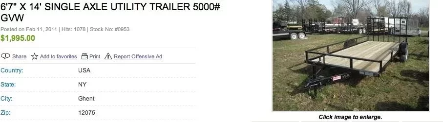

Trailer: 5000 lb, single axle with electric brakes 14 ft . (broken link removed to http://trailertraders.com/953-67-X-14-SINGLE-AXLE-UTILITY-TRAILER-5000-GVW/details.html)
TrailerTraders.com, in Ghent NY
Could be the perfect wood hauler for a SUV/Crossover
Wonder if they make it in 12 ft, (broken link removed to http://trailertraders.com/952-67-x-12-single-axle-utility-trailer-5000/details.html)

Loving the a la carte option sheets for those Heavy Hauler trailers. 5K single axles - nice!
I don't think it's very smart to pull 5,000lbs without trailer brakes though!
Not saying I haven't done it, actually 2 weeks ago I pulled a GN trailer that weighed about 22,000lbs with no brakes. Wiring shorted out and I couldn't figure it out (out in the middle of no where with minimal tools and it was -15*) Just took it slow, not that there's really any traffic to worry about, I think I saw 4 cars that whole day.
I think its very illegal in Mass.

If I had the 12' single axle / brakes, 5000lb model, I wouldn't have needed to go with the dual axle I just got.
I think it's the optimum wood hauler for tight areas & hauls plenty of weight.
For my use anyway.
With 2" plywood sides ;)
Yep, I agree, brakes even on smaller trailers are nice!
That's why to get the "tow package" & have it wired for "trailer electric brakes" on a new vehicle
