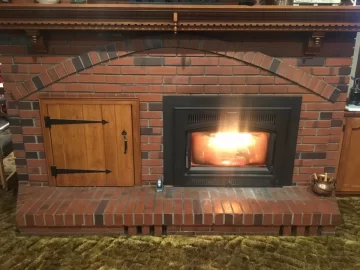

Here's a picture of my insert. We did the Wilmington Surround. (sorry for the glare. Notice the black edges around the glass. I took this photo about 10 minutes after a morning start-up. So the fire was just getting started. The black edges burn off once the fire gets hot). If I want to glass to be completely transparent, I just use a paper towel with a bit of water. Occasionally, I'll dip it into some fine ash, but that's rarely needed. A damp paper towel does the job and when it's clean you can't even tell the glass is there. I can take some better pictures if anyone is interested. Because the wood box is on the left and the door of the stove opens "left to right", it makes it very convenient for loading. The Kuma only had a right hand door opening, which had some factor into our decision. It didn't really seem like a big deal at the time, but we realize now how much better it is to have the door open left to right to align with our wood box. On the bottom left you can see the thermometer that came with the stove. It seems to work well and is used by everyone, including my kids, so we know when to engage the cat. The process seemed complicated at the time, but its actually very simple and my 10 year old often manages the fire (future wood stove owner in the making!).

The stove cruises between 800-930. I'm not sure I've ever seen the temp gauge above 1350.
I have the same insert. Got it installed last October so I've had it almost a year. I'm interested in your temp comment. I watch that temp gauge like a hawk as I'm so afraid of over firing the unit. At what temp is the unit "over firing"? I asked the installer several times and they never gave me a good answer. I try to keep the temp under 900 but sometimes it's hard to do. If I load it up for an overnight burn, let it get going for a bit and then shut it down, the temp gets way over 900 and still climbs for a bit before coming back down. My wood when meter tested is under 15%, most under 10%. I find the glass gets dark on an overnight burn, again, because I'm shutting off the air otherwise I'm going to bed with a fire blazing over 900. Also do you find the fan to be noisy? I keep it half way and use a floor fan to further circulate the air. I'm new to burning wood to heat my house. We had a fireplace growing up but that was an indoor fire pit compared to this insert. I would really like if the air control was more automatic. When I want to burn during the work day, I would have to get up at 5a, load it up, let it fire a bit, turn the air down/off and go to work to be in at 7a. It would be nice if there was a way that the air would start out low and let more in as the fire burns to keep the temp more consistent. Might keep the glass cleaner that way. I look to this forum for tips/hints at heating better with my insert.
