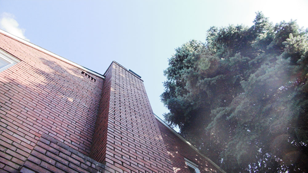

I'm considering installing an insert to revive my broken fireplace. The idea was seeming pretty good until a few minutes ago, when I realized there's a big tree that's kinda close to the chimney.
The tree in question is a healthy old spruce of some variety, better than 40' which puts it well above the top of the masonry and also much taller than any non-Dr. Seussian chimney extension could possibly reach. The trunk is about 15' from the centerline of the chimney, but some branches level with the chimney cap come as close as 7 feet away. And of course, they grow.
What rules apply in a situation like this? Is it the 2' above any obstacle within 10' rule that's typically applied to building parts, or something else?
Before you ask -- we like the tree. I'm willing to trim, but not remove it.
