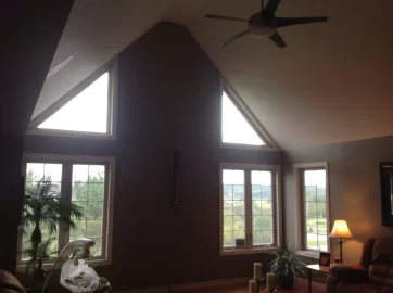

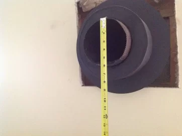

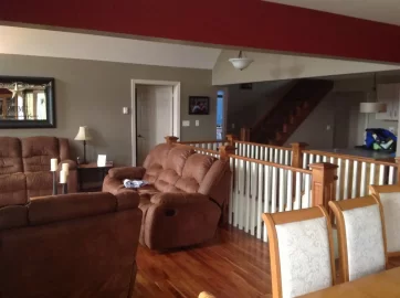

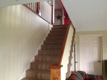

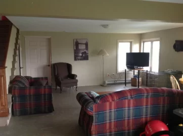

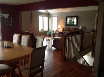

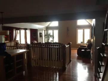

Hey folks! I've been checking this place out for some time now and have learned a lot so I thank you for that. Now for my situation...
Through my research and findings I have come to understand that a Pacific Energy Summit would be the best choice for my newly purchased home. I've been looking forward to this purchase all summer and today was going to be the big day... Until a salesman told me he gets better and faster heat from a PE super series or the PE alderlea. He said many of his customers have returned their summits in exchange for these two options as they "throw" the heat better.
His analogy was that if you were to thermo gun all three side by side the summit would certainly put off the most heat but because it didn't actually project and circulate the heat as well as the other two PE models many people were let down by the performance. So because of this he stated that many of his customers say they can feel the heat further than the summit. Needless to say I am troubled. Everything I have read here has said the summit is a strong purchase for large homes (2500+ sqf) and that most were happy with their choice. I don't want to discredit the salesman as he was quite understanding and not once did I feel he was trying to push a sale, secondly this guy has been owned this store for 30+ years so his words carry weight. I figure return to the kind folks here and bounce some ideas so I can pull the trigger on a stove before we get into the cold white stuff.
Below I've attached some pics so you get an idea of what I'm working with for the unfinished room it will sit in and the upper level I'm hoping to assist in heating. The stove will sit where the dog kennel currently resides. As you can see the stairs will be the cold air return and I plan on installing a direct vent above the stove to assist in circulating the air between floors.
I should also mention the salesman saw these exact pictures and recommended the stove be installed on the main level, but for now for plug and play as well as cosmetic reasons - wife - the stove will remain on the lower level.
Any suggestions as to what stove or other ideas to maximize the stove of choice would be greatly appreciated.
Cheers

Welcome to hearth.com. That is a lovely home you have. Based on what I see and what you've said it seems like you are on the right track. PE stoves are all convective and in this case that is what you want. It's going to be harder to heat the home from the basement room but the open staircase will help. The T6 looks like a good fit here and the Summit would do the job fine too.

As far as original poster goes he is putting a vent in to help the heat loop so I think its not going to be a big deal for him which ever stove he goes with but like it was said above the bigger stove is the way to go as he has a pretty large house to heat.

I dunno much about the stove choices, but I have to say you have a really nice shack....
