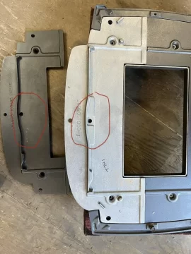

If you have to replace the bottom as well, make sure you dont need a new front bottom to go with it. They updated the pattern to try to prevent cracks, and that front bottom piece had to be changed as well. I think its $80 your cost, but if you dont get it, then it wont fit back together right. And I just bought the last one of two that are left in the states last week. So woodmans is the only place with 1 left in inventory. Eta from jotul is Jan for more to be here.
Here is a picture of the new front bottom mounted vs the old one, and I circled the difference.

So if your front bottom looks like the gray one on the right already, then you are good when your new inner bottom arrives. If not you will need the new front bottom.
