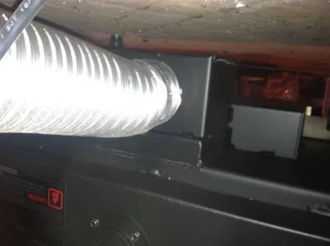

Bb mine must be diff did they change the 2013 model? Mine looks like it gets all air from the round thing in the back that the oak is hooked to and then the two under legs bc there is no rec tangle hole in back only the square box where the oak is.
Is your on the pedestal? If so you can't see the secondary inlet.
Does your cap have a screen? If so, make sure it hasn't clogged.
No screen on my cap and no it's on legs. Here's a pic of the back.
