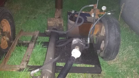

The PTO shaft coming out of the tractor was stopping completely? That would mean it is stalling out the tractor, no? If possible take a picture of the setup you're running and I'll be glad to help.

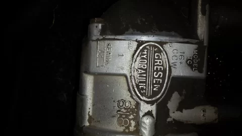

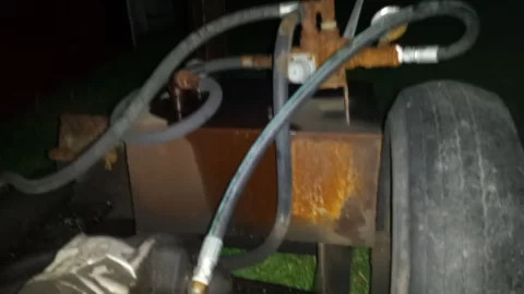

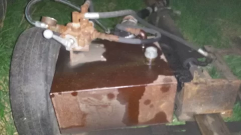

It looks like the reservoir is around 2/3 full of oil. I had added some.
Hopefully these r usable

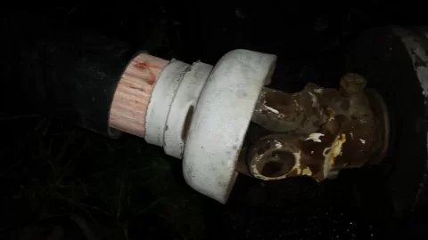

It really looked like the shaft where it went into the pump stopped turning. I had the tractor rpm's pretty low, but didn't notice it grunting really bad or stalling. The shaft only appeared to stop for a split second. I will say that the fact that the shaft seemed to be stopping spooked me a little so I don't really remember what the tractor was doing.

Your WD45 has a 254mm dry disc clutch to operate the pto, if the pto stops and the engine does not, then the pto clutch in the tractor is slipping and needs to be repaired. They stopped building that tractor in 1957 and it cost around $2,400 then, so it doesn't owe anyone.

Assuming that the PTO is engaged (they will often freewheel when not engaged, but with no "power" behind them) The tractor in neutral with the clutch let out...if the PTO stops and the tractor doesn't - you have a tractor problem. Likely the PTO clutch as stated above.
First step is to make sure that you have the PTO actually engaged and the clutch is NOT depressed in any way.
Shear pin broken ?
No shear pin broken. The PTO was definitely engaged. Does really appear to be a tractor problem.
