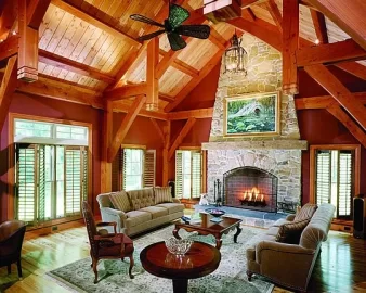

I would go with a Rumford. I am also going that route in our 3400 sf home. I have taken a little flack here for doing so but nothing beats a roaring fire in a Rumford. And they do make a lot of heat. I just can't get excited about a hot black box in the family room.
This is kinda what I am aiming for:

If you're looking for the occasional ambience of a roaring fire in living room, there are probably better choices than the Rumford.Keep in mind you posted this question in a wood heating forum, so we will try to convert you to 100% wood heat, whether you like it not.
