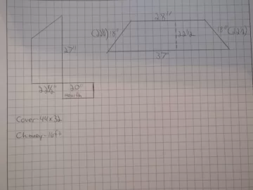

Just purchased a home, which I will be putting a wood burning insert in. I have never dealt with an insert before only free standing stoves and have one or two questions for those more experienced than me. Pictures are below one of the outside and one of the inside looking up:
The firebox is metal not sure if it is what's considered a zero clearance or not. Will I have to remove the whole thing or can it stay? If it stays I'm guessing I'll have to grind out the trapezoidal flue.

- Opening Sizes
- Front of stove 37"
- Back of Stove 28
- Angled sides 18"
- Height of opening 27"
- Depth 22 1/2"
- Hearth 20"
